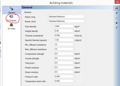

You will only get that if you click on the General button, instead of the Layer button in the first dialog.

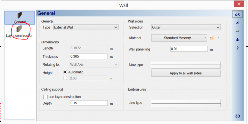

Here are the steps. Click on the buttons indicated in red:
1. Double click on the wall to activate this dialog:
2. Double click on the Layer construction button, which will activate this next dialog:
3. Double click on the Material button which will activate this dialog:

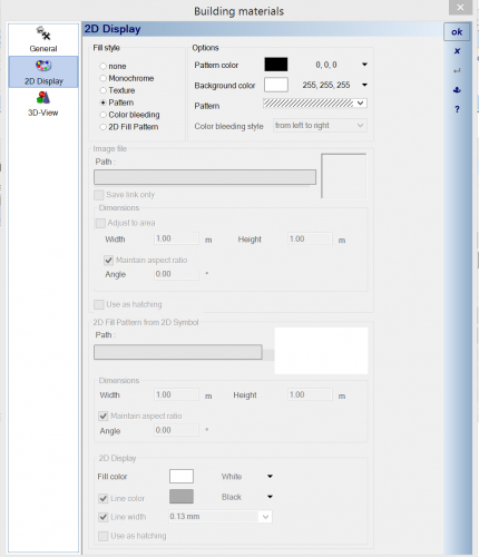

4. Double click on the 2D Display button
