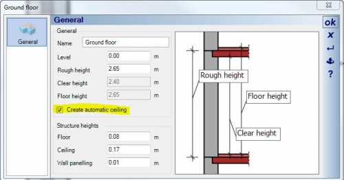

You have Create automatic ceiling switched on, which does not work so well with mixed wall types.
Switch this off and draw your ceiling manually using Building - Ceiling - Insert with polygon tool.
You will need to add your own stair well, using the ceiling cut out tool.

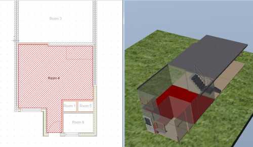

I created a Room Boundary layer and added the Room 4 to this. I then created another layer for the utility room which is for rooms 1, 5, 6
The issue i now come across is when you look at the plan in 3D with the ceiling turned on only 1/2 the building show it.

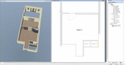

Jamie, Looking at your project (via email) I can see your problem. In fact there are several problems and as you guessed all relate to the use of the room boundary.

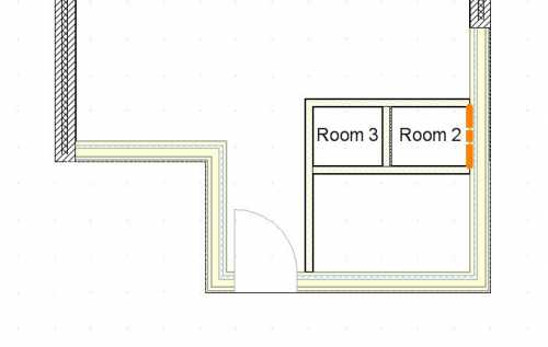

Your Timber walls and Solid walls are placed correctly on different lays, but your attempt to join them using the room boundary failed. The room boundary must be on the same layer as the wall it is trying to connect. Sometimes when it is difficult to make a connect, place the room boundary on its own layer
This is more obvious if I hide the Timber wall layer. I suspect you were also trying to include Room 2 and Room 3 within the room boundary, which would not work. Where you have a situation I suggest you make a new layer just for the room boundary an make an entire room out of the room boundary to ensure you have a good connection:
With the timber wall hidden so you can see more clearly.
