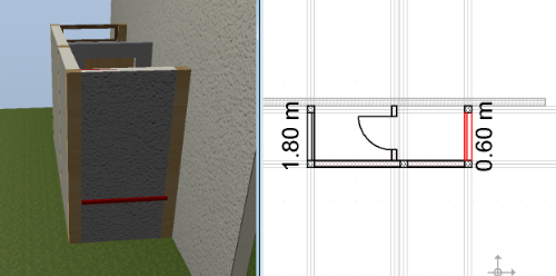

difficult to say and depending on the current wall / window situation. Not a general problem.
Please send your project file to customercare@visualbuilding.co.uk and we will check that.
Thank you in advance
Thomas

Here's the screenshot

Hi, I'm new to this software, I've 'built' a copy of my house without too many issues. However I want to design and build a porch, with WC on the front of it.
I started a new project just to practice first. The walls are timber framed, and the wall profile shows the frame, renderboard, render, plasterboard and plaster. the corners, and either side of the door are a 150x150mm oak beam. Everything was going good up to the point of me putting windows in.
The first window went in fine and displayed as I would expect on both 2D & 3D, the second window looks the same on 2D but doesn't seem to have removed the wall. as it is sunk in the render. I've attached a screenshot if that may help clarify what I'm trying to explain.
Is there anyone who may be able to help me please.
Thanks, Dave
