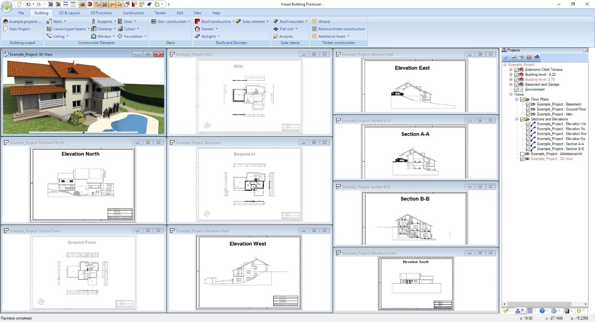

For example, the building in the following screenshot has 4 roofs. One for the main building and another for the two-floor garage extension on the left. In addition, a lean-to roof over the porch on the left and another lean-to roof with the glass cladding over the two-floor extension for the children's room and the terrace. Strangely enough, this roof protrudes over the main roof, but that is actually how it was built in reality.
As you can see, the project has a total of 4 buildings, one for each main building level and one for each extension.

- In Visual Building everything is drawn to scale. However, you can set the scale for each 2D view as desired
- Create as many 2D views as required in a joint project. One view for the ground floor, one for the upper floor or the basement, etc. This way you can easily separate your house extension floor plans
- If necessary, generate section views and elevation views of your extension with just a few mouse clicks, everything you might need for planning application or to get a quote from your builder
