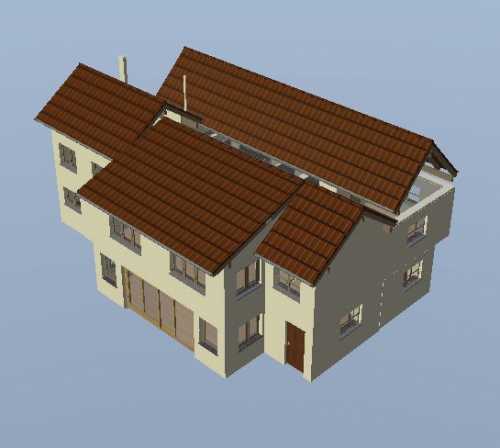

The gable in your 1596 building: You should have created yet another floor (eg call it attic) for each section of the building that this roof covers. The gable walls would then appear. Currently you have no walls in the floor that you have named Roof. Think of it that even an attic has a floor and walls.
You could create such a model outline, as you suggest, just to create the roof, then export the roof as a 3D model, and load that roof object onto your comprehensive model.
To create such a complex roof, you will need the Visual Building Premium's Roof merge feature. You can of course use the Premium trial version to create the roof and then use that object in your Professional version.

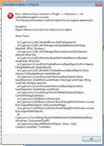

I will forward the error message to our programmers.
If you do use the Premium Roof merge you woul dneed to transfer all the individual roof parts to the same layer so that you can merge them into a single roof construction.

I have hit a problem - in modelling this house, I have erected buildings in the order that this house was built. However, I now find roofing rather difficult. Two of the four roofs needed are fine (South and South East, nearest the viewpoint in the jpeg attached. The third and fourth roofs have decided not to move in response to the properties dialogue box - I can neither move them up nor down.
I also attach an error message from the deletion wizard - telling me that it would help you to see that error message. This error message happened after I had developed the model further, attempting to find a different route through the situation.
The four roofs in the jpeg attached are very near to correct in plan view, just not all at the correct height and some gables are missing - wanted to make sure I could do the roofs first.
Your thoughts would be appreciated.... Perhaps I could choose to cop out and generate a new model as one building with no interior rooms, and roof that, to use when the exterior view is required? How do I put four roofs on one building?
