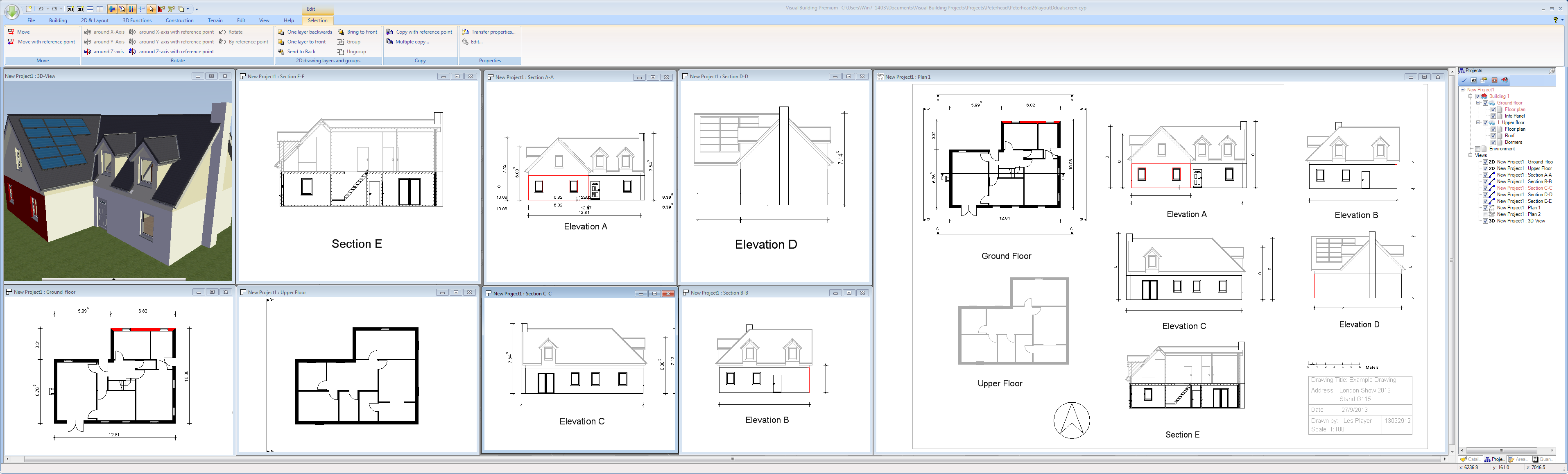

Yes- but you dont need to run 2 programs at the same time, as you can load both the before and after projects into Visual Building.
Also you can stretch the application window across two screens if you have a dual screen system. This gives you a lot more working space.
The above shows a single project stretched across a dual screen (2 x 1920 x 1200) giving a lot more room to display multiple views.
This allows you to edit any view and instantly see the changes in all views.
Also you didnt need to make 2 projects as you can edit an alternative designs on a new layer and switch layers to show the differences.

If I have 2 screens connected to my computer, is it possible to run Visual Building as 2 seperate programs to compare a before - after situation in a design proposal. I need to show a client the changes in 3D.
