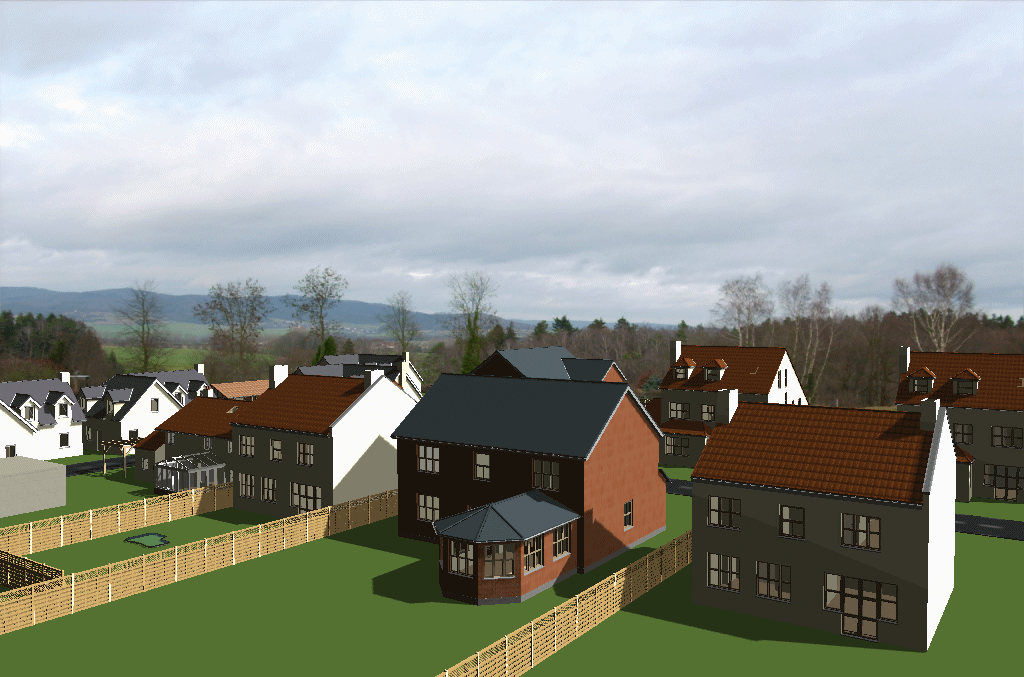

2. Use Master Project
For a very large project that incorporates several large buildings. each building can be a separate project. You can then save each building as a 3D object and then load each object into a master landscape project.
Click to zoom
The above projects uses several projects that have been saved as 3D Objects (.cyg) and then imported into a master project.
This method is preferred if you need to create 3D visualisations.
