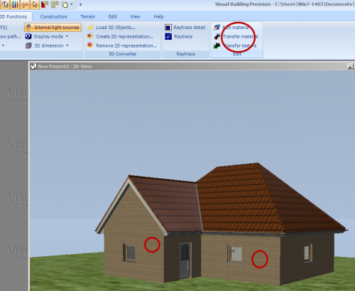

In the project supplied, the properties are transferred correctly. BUT most of the properties for these two walls are the same so I'm not sure what your intention was. The height property does change, as it was different. You can test this by making the target wall thicker and then transferring the property, and then the target wall assumes the same thickness as the source wall.
The only other difference in the wall is the texture/material, which you will notice is not in the walls property list. (which after re-reading your question you did refer to) . The references to colour material etc refer to line colour / style in 2D view- not 3D view. I will clarify this in the documentation.
If you want to transfer the material properties of a wall in a 3D view, then you must use the tool:
3D Functions - Edit - Transfer material
For more complex material/texture fills of walls use the Surface Area tool.
