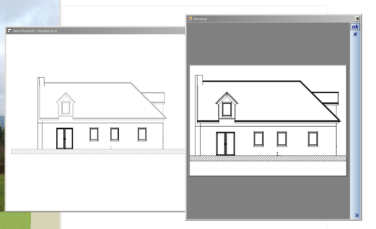

When you print the view. all lines will be the same colour black. The grey lines that indicate other layers are only seen in the screen view.
The left view shows the screen section view with the lower floor black (selected) while the upper floor is grey. The right hand image is the preview of the printed view- all lines are the same colour.

Is there a way to create an elevation view where the ground or upper floor is not greyed. I realise this is because one of the building levels has to be selected and therefore appears outlined in black where non selected elements appear grey.
I would like all levels of the building to appear black in my elevations view.
