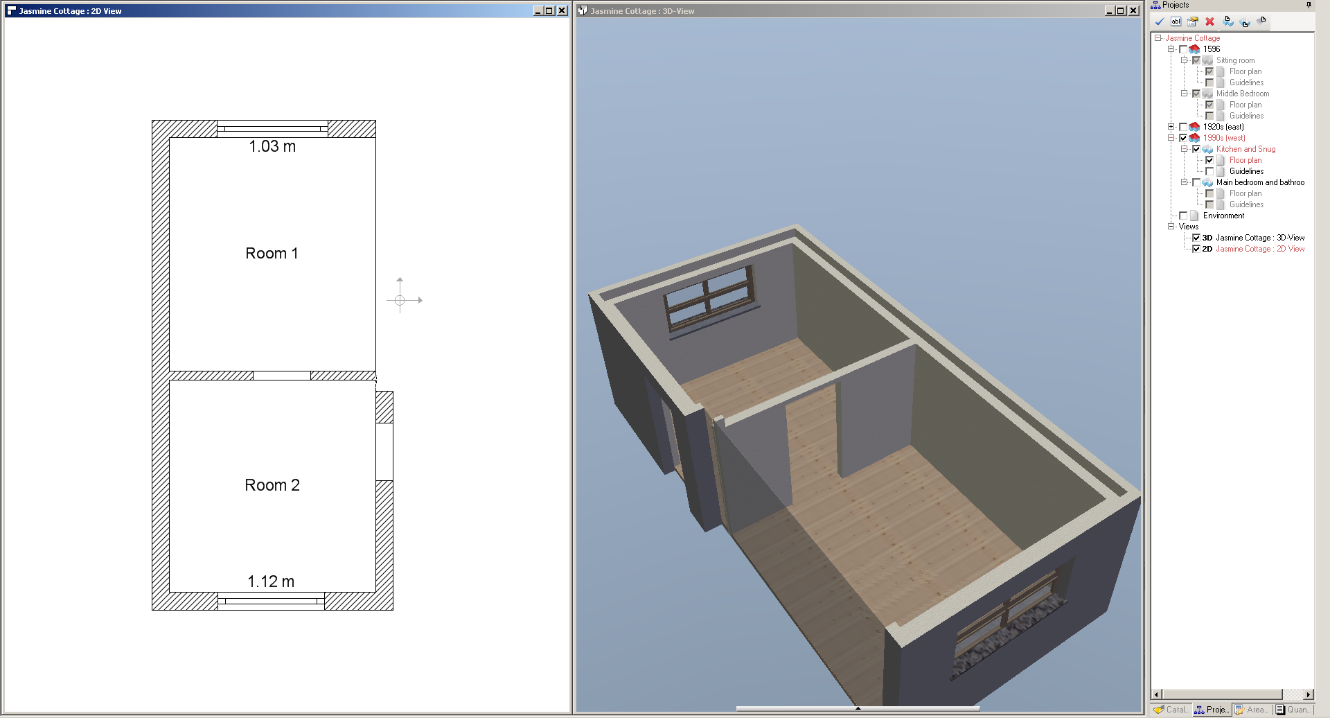

Floors and ceilings missing.....! 13 Jan 2014 09:26 #1182
Concerning the missing floor problem. I examined your emailed project and the problem is in your Kitchen and Snug layer, due to the Room boundary element not making a good connection (as marked ). I deleted and redrew the boundary wall. I have rectified and will return the project to you. If you duplicated the next floor from the ground floor the same problem will also occur on the next floor.
Note how in the 2D view the room is automatically named and the floor appears in the 3D view, which only happens when you have a good wall connection on all walls that define the room.
Room 2's right hand wall was made up of 2 non connected walls which is now 1 wall with a cut out inserted.

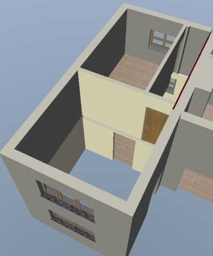

Floors and ceilings missing.....! 12 Jan 2014 17:01 #1177
I have built my first model, but have a problem that I think might stem from the levels - there are three buildings making up the one house, to model the previous extensions and differing floor and ceiling heights. Now, the original building the first floor flooring is drawn in place, but part of the ground floor flooring is green. The second and third buildings have no floors or ceilings..... The partially missing floor in the centre of the ground floor echoes the partition wall above, which has no ground floor equivalent.
I have checked all the property settings I can find, but I have no clues yet. I attach a pdf which shows the problem.
All the internal levels seem correct - there is a step up from the central core upper floor to enter the newer bedrooms for example. I have yet to add another extension, which squared the building off in the late 1990s, but don't want to go further until this model is behaving itself... ;-)
