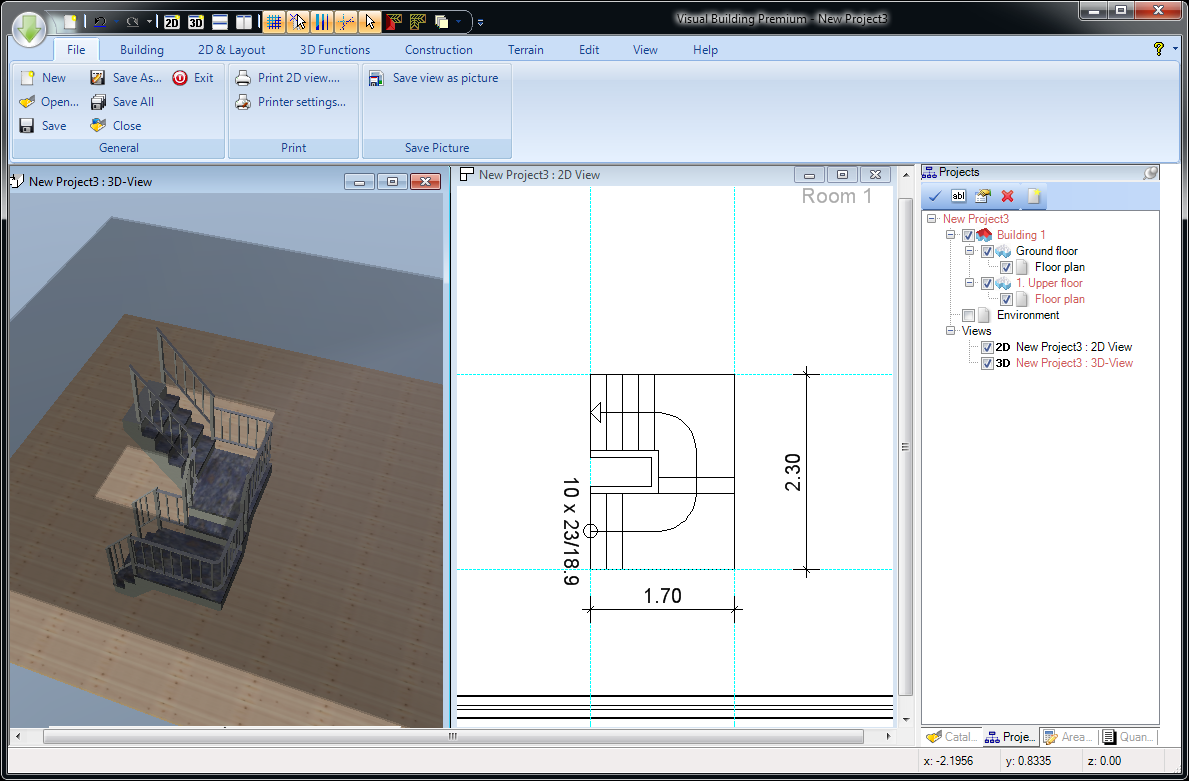

Excellent, I took your advice and opened a new project - and when bounded by just four guidelines the whole thing is easy! The lesson for me is to make things as simple as possible. Now to play with the options.....
Thanks,
180 degree staircase 02 Apr 2014 22:58 #1366
There are still a few variables, but in the above example I made some assumptions. I used the 'Stair with landing' stair. When placing stairs you will find it easier to mark out the bounds of the stair with guidelines and snap the stairs to those.
On reading again I noticed the 2.3m length, which produces, provided the stair width is reduced:
I would always make such trials in a seperate project, before commiting to the main project.
Remember to terminate the stair input with the Enter key otherwise yes it goes 'haywire'...
