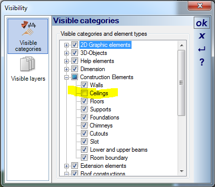

Hi, Thats great, sorted now. thanks

Its likely that you have automatic ceilings enabled:
This is the default and so ceilings are always added, BUT also the display ceilings is also disabled, so that you dont get to see them. You have possibly switched this on.
So switch off the ceilings in the Visibility dialog. Each view has its own visibility settings.
Delete Ceilings 03 Nov 2014 18:06 #1805
I have put ceilings into my model and would like to delete them. undo and highlight and delete do not do it. Is there another way I'm missing.
