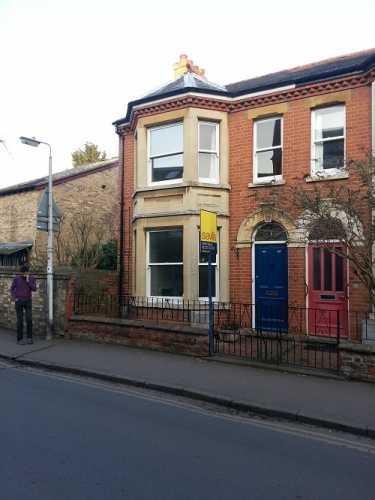

Many thanks for the help. I did not realise that the main front roof section was really actually two sections that join up. Duh!
I am still not quite fixed with the roof though, because the ridge at the top of the bay section is actually horizontal rather than sloping (see attachment) and I am still wondering how to solve that one?

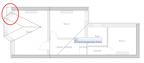

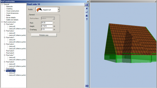

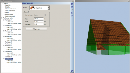

I examined your project and the overhang on the section in error is 0.5m while all other overhangs are 0.1m. So make this change and your roof will be correct.

I also have a difficult roof line problem (see attached screen shot). It concerns a terrace house with a bay front. The problem concerns the overhang on the front main roof slope (left hand side of the plan). The overhang on one side of the roof is 0.1 M whereas the overhang on the other side seems to be more (see red circle). What do you think is going on? And how to fix it?
