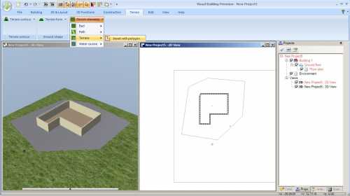

Are you using Terrace or bed tool (either will work) as follows:
Although I used the Ribbon UI version, the tool worked exactly the same for older versions.

Thanks for the reply. I have defined my plot area using the terrain tool and I can see the corresponding outline in the 2d plan. My problem is that I cannot see this on the 3d plan. I only ever see the default environment square. I was hoping for a way to easily see how big the plot was on the 3d plan.

Adam the plot object that you refer is the Environment block, and does not really represent the plot. To add a plot which is normally a polygon or rectangle, use the Terrain tools. It often helps to create a layer specific for the terrain / plot.
Incidentally you can change the size of the Environment block, by select the Environment layer and then double clicking on the block, and changing its size in he activated dialog.
