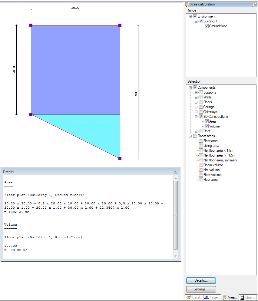

If you have converted the 2D polygon into a 3D object it will appear in the Area Calculation report located in the Area tab, next to the Project tab. You must have the 3D Constructions and Area values enabled. The calculation formulae is also optionally displayed.
Also for Premium users, if the polygon area happens to be a room enclosed by walls, you can also use the Area calculation report for that room located in the Area tab, next to the Project tab
