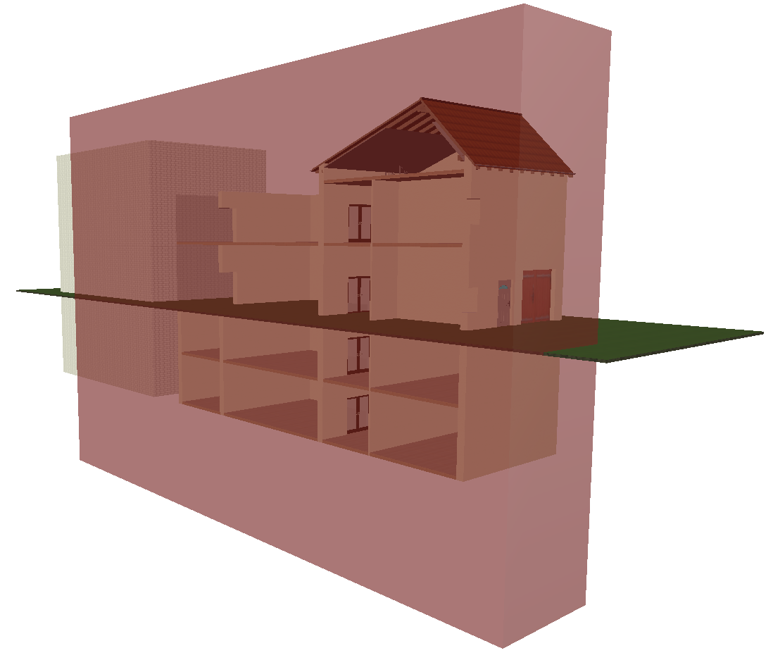

Robert,
Just move the subtraction solid from the Environment layer to any other layer (or create a new layer just for the solid) and deselect the subtraction solids from the Visibility selection for that layer, in the 3D view

Section View Basement 18 Apr 2015 21:15 #2116
I emailed my project as requested, and as you can see I have managed to create a subtraction solid. From your past help I can exclude the section of the adjacent building at the rear. If I want to hide the solid I can switch off the Environment layer, but then I lose the ground plane. How can I hide the solid. Can you help me please.
