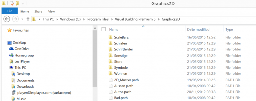

If you have put the folder in the correct path they will 100% appear in the catalogue, so you must be putting the new folders in a different path to that which I said.
When adding new folders you must also update Visual Building with the availability of the folder. This is achieved simply by changing to another catalogue, and back again, or restarting Visual Building. Email me a screen shot of showing the actual path and folder structure in Windows explorer similar to the screen shot created above. How do I create a screen shot See also: Where are my files |

You can easily create your own folder using Windows File Explorer. Just create a folder in
C:\Program Files\Visual Building Premium 5\Graphics2D for example Scalebars and that folder will then appear in the catalogue. Then copy your scalebar.cys file into the Scalebar folder. I will update the training documentation to clarify these points for future users. |
