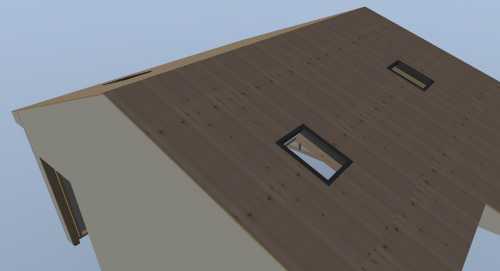

You need to set the cube property to cut objects / models on all layers:
You can build the skylights from scratch or export a skylight / window objects as a .cyg object, which you can then import as ordinary object and place as required.
The Surface area tool is best way to add a texture to the roof plane, but be sure to give it minimal thickness.

The Model attached is an extension of the earlier Project I was working on (which you've helped me out on), where I am now designing the Garage part using entirely the 3D construction tools. (Luv the Cut at Plane option by the way !!).
I have created and placed 3 Primitive Cubes, which I then converted to Subtraction Models, to cut through the Roof Plane (sheeting) at the correct position and angle. I am not achieving the desired effect (i.e still no holes in the Sheeting). Never had this problem in the past. If I move the Subtraction Models around slightly in the 2D view, they appear to Subtract the intersecting Roof Supports (as I would expect) but the Roof Sheeting still remains solid. Any Thoughts ??
I intend to add 3 Skylights, how I can I do this if the roof section is not recognised as a "Building" product.
