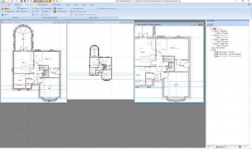

Hi Robert,
When renaming these views just please ensure you rename at the end of the View title sentence.
Visual building will not allow changing the name of the project view in this manner but will allow you to rename the View.
E.g
New Project1: 2D Views
New Project1: 2D Views Example Name1
New Project1: 2D Views Example Name2
I've attached a screenshot of my screen for an example.
Kind regards,
Customer Support

Does anyone know why, if I use the 2D button to create a new view and subsequently rename it the other views will also change to the same name? Does this not seem to negate the whole point of creating views if you cannot name them independently of each other?
Does anyone know how you can create a duplicate view, that can subsequently be modified independently to show an alternative proposal?
Further update: I've now noticed that if I do the above and have duplicate names for views in the Project Viewer, then subsequently open the views-deleting-wizard then the views are named differently here, ie reflect the name changes I tried to make in the Project Viewer. The Project Viewer however still shows them as being the same.
I'm assuming this therefore is a bug, but if it is it is quite fundamental to setting up projects. I'm operating from Windows 10 which could be an issue.
