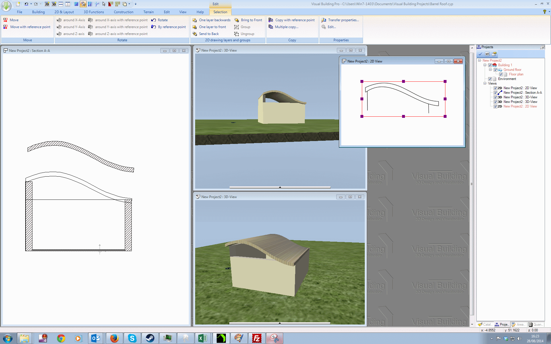

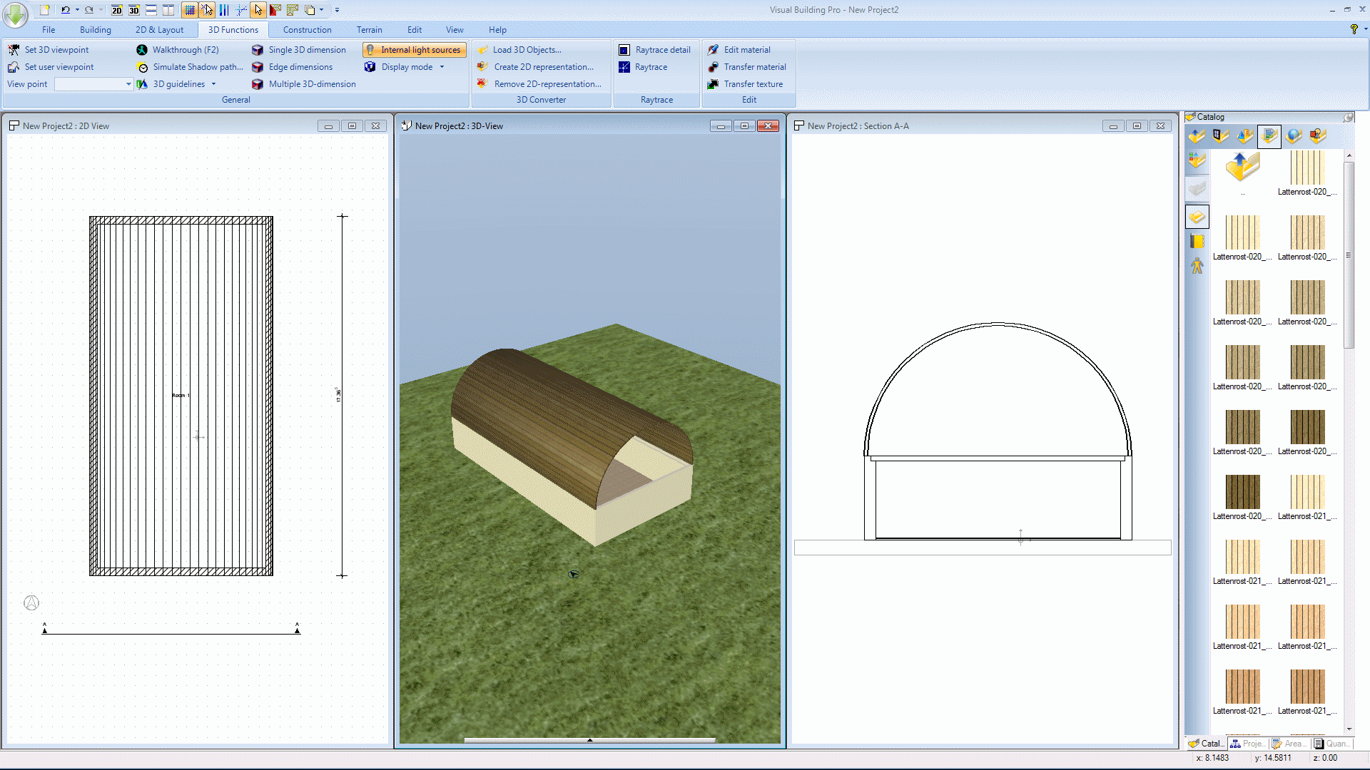

Although there is not a barrel roof in the roof construction tools, it would be possible to create one using the 3d tools available in the Pro/Premium versions.
The following was quickly created using the 2D tools to create an outline front elevation view of the roof. This was then extruded into a 3D shape using the Extrude solid tool. These tools are a feature of the Pro/Premium versions.
1. Create outline using Arc and line tool
2. Select the shape and use Edit 2D Graphics - Create Contour
3. Ese Construction - 3D Construction - Extrude sold to create the solid
Because you are extruding an outline you can create any shape.
Here a contour was created by tracing over an imported 2D image. If you had the image as a dxf file you could use that to accurately creat the contour.
Visual Building Training Course manual contains a detailed description of this feature
