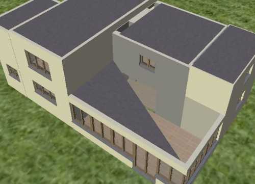

Triangular ceiling in a completed room 23 Feb 2014 18:48 #1309
Chris,
I loaded the project you supplied and could not reproduce the effect you show. I assumed you tried to clear by saving and reloading the project. (Clears several visual artifacts).
I have seen triangular ceiling before, which are normally caused by badly placed walls- which is not your case.
I was however able to manually add a ceiling without problems.
Triangular ceiling in a completed room 23 Feb 2014 18:16 #1308
Hi again,
I can't quite work this one out - the Garden room seems complete, has a floor and room name, and a dotted boundary wall (- nice design touch!)
However, the ceiling is triangular - I have no clue what to look for to remedy this, when the room is complete and the wall heights are the same. One possibility is that the different ceiling height in the utility room might be causing a problem?
Any ideas appreciated, thanks.
(Enjoying 4.02!)
