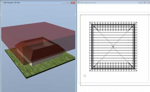

2. Create an Subtraction solid object to remove the roof part you do not need

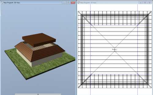

3. Hide the Subtraction solid block
4. Use the Extrude solid tool to create a block that fills the new void, giving you a new flat roof.
5. Resize and lower the new flat roof into position

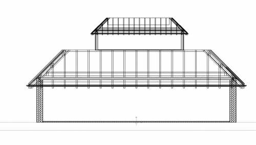

6. Create your roof canopy as a seperate project, save it as a 3D object and load into main project. I cheated and saved this example as a 3D object, loaded it in and resized it and placed on flat roof.
7. Create elevation view and adjust roof and roof canopy as required.

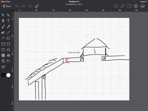

Pitch roof to flat roof 07 Aug 2015 10:54 #2296
  • Dave Hickman
  • Dave Hickman's Avatar Topic Author
  • Posts: 11
I a bit lost how to proceed
I want to draw a small canopy roof say 1m slope (what ever pitch) leading up to flat roof with a lantern roof on top
UB off gables to suport mono roof
Any help would be appreciated
