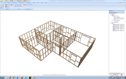

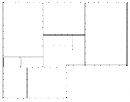

Re: Wall construction 28 Jul 2015 11:57 #2262
Jamie,
There still is no automatic framing method, but there is nothing to stop you doing this manually. I recently did this for a timber frame porch:
It's OK for a small extension, but Im not sure I would want to use this method for an entire house. You simply place timbers in the 2D elevation views, and hide the solid walls.
The above is in the Visual Building Training manual, where the timber roof is created in detail, and the wall timbers would be created in exactly the same ways.
