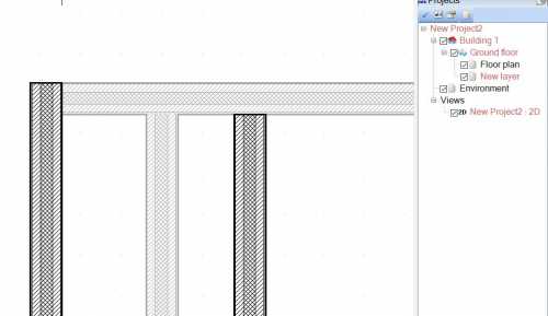

Another method or "trick" is to put the walls on different layers, in which case the wall will not connect in the normal way:
Use the Room boundary wall type to define the wall in order to achieve the room integrity.

Wall connection 07 Aug 2015 10:40 #2295
  • Jamie Cox
  • Jamie Cox's Avatar Topic Author
  • Posts: 8
Hi all
I am trying to get the two walls to connect by butting to each other. One of the walls is standard Brick the other is timber frame but what ever i do i cont get the to butt to each other they always join
Is there a trick to getting the walls to butt up.
Thanks
Jamie
