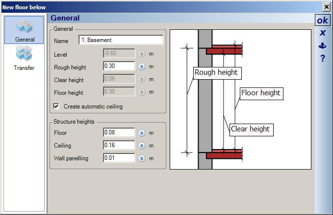

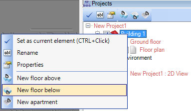

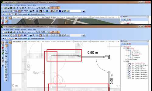

I looked at the project that you emailed to me and it appears that when you created the basement, you transferred all components from the Ground floor. You should have transferred only the walls, or better still - not transfer anything , which would allow you to create a new plan on the basement level.

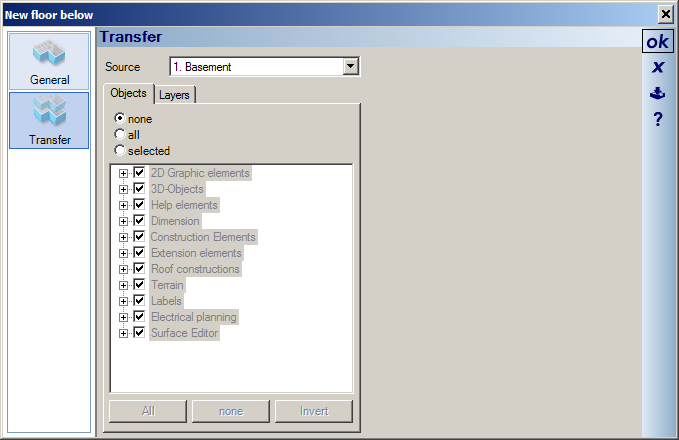

After selecting New floor below this dialog will activate. Click the transfer tab on the dialog
Then in the transfer dialog select the transfer to None. You can now draw your new walls as required on the new floor. You can even snap your new walls to the Groundfloor floor plan to ensure you have the same exact wall position.

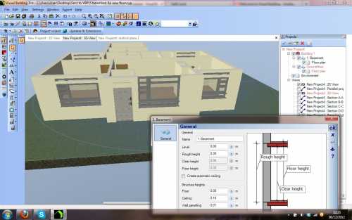

Hi,
Thanks, i have try ur steps and i now have this , i don't think its changed the wall heights?
can u help
regards,
Charlie

Delete the conservatory, and then on the building add a new floor below the current floor, ignoring doors and windows. Set the new floor height to be 30 cm (default was 2.8m)

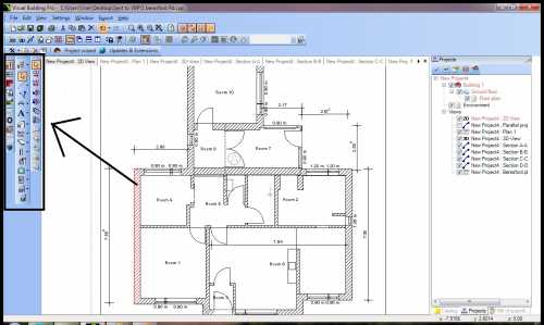

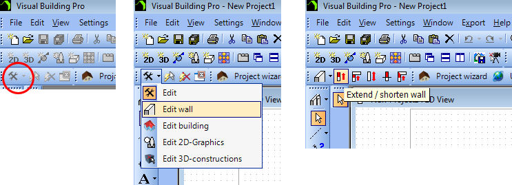

Re: Floor Problem 29 Nov 2012 21:28 #500
I can see the tool in your screen shot. Its the first tool on the left just outside the box you drew.
Click on the icon with a hammer and spanner.
This is also explained in the Wall Editing tutorial video. .
Remember that the toolbars move around a bit (but not on their own accord :0 )
Applies to all versions of Visual Building
Re: Floor Problem 29 Nov 2012 20:33 #499
I cant seem to find the Wall Edit Tool on my setup?
