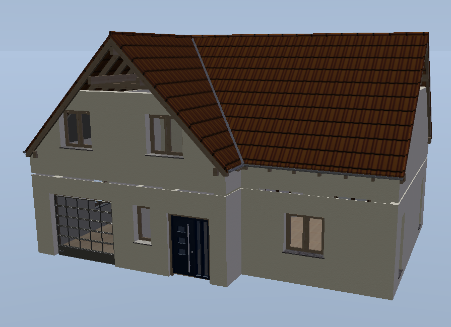

The gap that is visible is the ceiling. To remove this gap enable the ceiling in each of the views.

Then also for each wall set the Wall height back to Automatic.

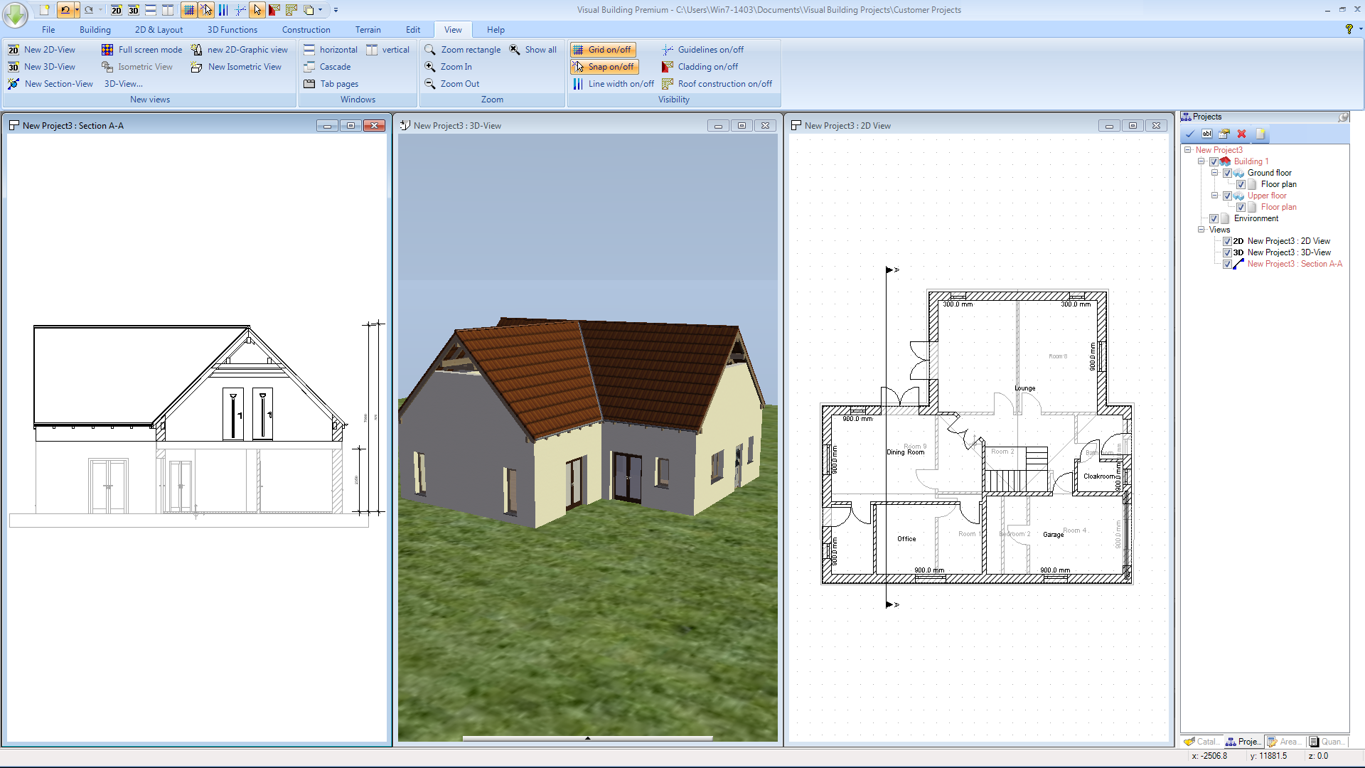

The ridge was 7070 mm above the FF, so I dropped the roof by 70 mm (via Roof Construction Properties). This can be seen better by crating an elevation or section view as below:
Click to zoom
Click to zoom
To remove the space in the attic wall, you either have to insert another floor or increase the floor - ceiling height. The latter is best but then you have to insert your own ceiling manually.
